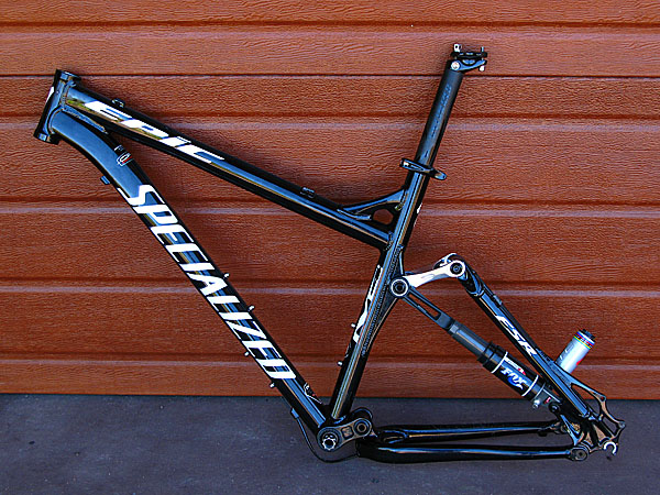

Well, it seems showing the stages of a build is the "in thing" at the moment, and since I'm about to start the process, here's my new (to me) Specialized Epic frame as I bought it. (Note the obligatory garage door back-drop ....)

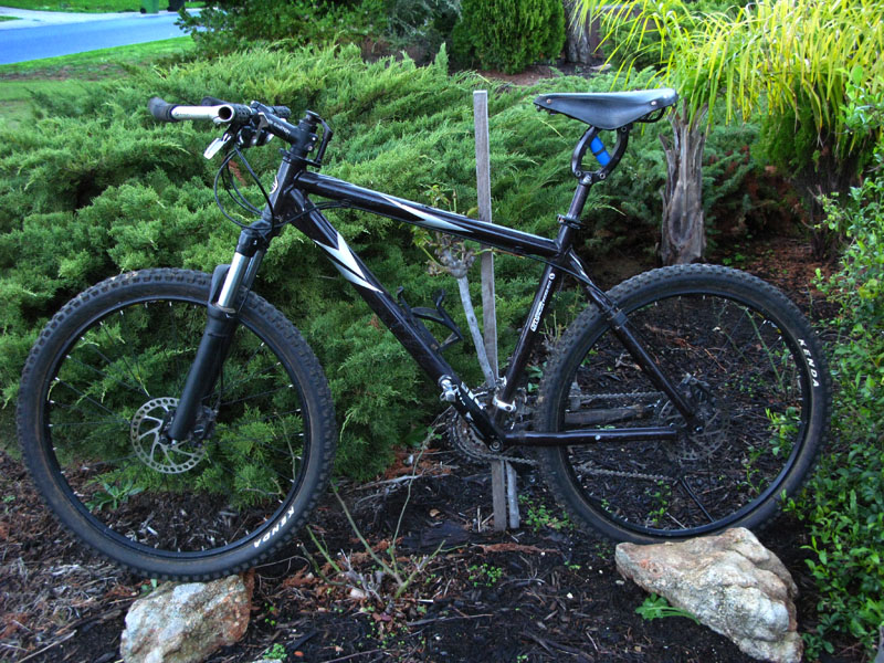

I'll be transfering most of parts from the my Giant XtC across (shown below), but I won't be needing the Thudbuster suspended seatpost any longer .....

whats that above the headset on the xtc?

toolonglegs wrote:whats that above the headset on the xtc?
Looks like a Hopey - http://www.hopey.org/

TooLong, see this threadfor the gadgets I love .... ;)
Needsapush, I'm too old to take up DH riding! :) This is a XC frame, as is the XtC, and that's the type of riding I like. I love climbing more than decending, actually.
I'm expecting to be on it a few days after Tim Hopey sends me the replacement bracket for the damper. I'll see how desperate I get - I might end up taking the bracket from the XtC across with me, but I'm hoping I won't need to. In any case, I can't ride at the moment - buggered a muscle in my shoulder during the week and I'm laid up.

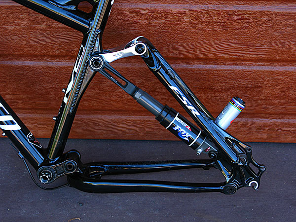

Setting the sag on the bike was a saga, as noted in this thread. After doing a search, I found out the rear shock takes about 20 seconds to sag to normal ride height after climbing onto the bike. I put a cable tie on the stanchion, climbed onto the bike and sat quietly. At the recommended pressure (for my weight) of 105 psi, I achieved about 20% travel, so that's where I'm starting with this bike.

I hate to break the news to you Richard, but this isn't a "new" suspension system any more. These came out in 2003, if I recall correctly. Some of the current stuff is simply amazing, but I can't afford that end of town. :( Current systems have some very clever linkage assemblies combined with platform shocks ("Pro-Pedal") and/or remote lockout in front and rear to provide curved travel paths, zero brake jack, reduced pedal input, virtual pivot points, etc., etc.
However, I'm quite happy with this one - it was way ahead of its time when it was released, and as you can see from needsapush's new bike, they have only tweaked the concept since then (better shock now than on mine). These Epics are designed to act like a HT until bumps are encountered. That's a style of ride that some racers really like - the ability to stack the power on without compressing the suspension is much sought after.

Looks good :D ...be interested to hear what the rear suspension is like climbing,seated and standing.I must admit I hate even the slightest bit of bob.For one reason other than loosing power is that it does my lower back in.
toolonglegs
Posts: 13021
Postby Kalgrm » Mon Nov 26, 2007 10:00 am
I reckon Needsapush will be a better person to answer this particular question since he has the current model.
Having said that, the newer versions have modifications to the shock which will make it easier to induce bob, since they have the controls which set the threshold at which the shock "lets go" (Specialized call it Brain Fade).
In my very limited testing to date, I can't make it bob when the track has no bumps in it. I reckon you, on the other hand, could make it bob to the point of breaking! ;) Nah, the way they've designed this thing means it will not bob under any amount of power until the suspension becomes active (ie. when a bump forces the rear wheel up).
They've also installed the Brain on a backwards slope so that the steeper the climb, the bigger the bump must be before it overcomes the inertia of the brass piston within. It means on climbs, the shock is almost always locked out, while on descents it's almost always active. They are clever bastards at Specialized .....
(The Brain fade was introduced because riders wanted the ability to set the size of the bump which made the shock active when climbing a hill. Sometimes it's better to sit and spin, allowing the bike to absorb the bumps as you climb. Unfortunately, that means bob more often than not when the suspension is active.)
